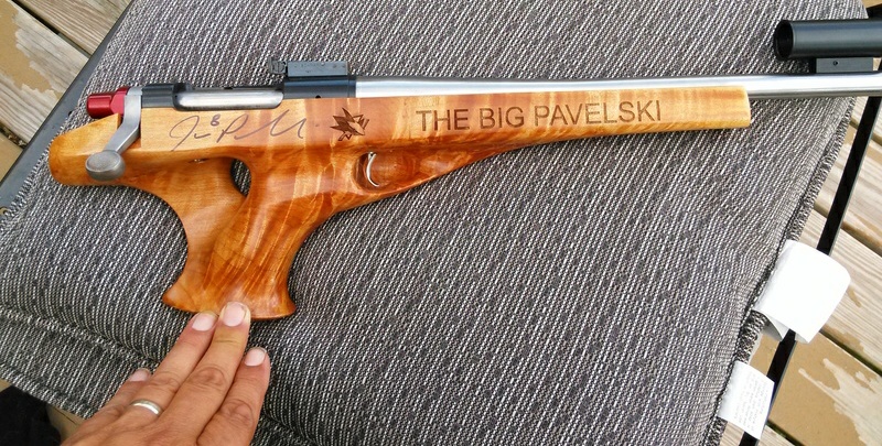

Now I know this picture is of my unlimited gun BUT this is a perfect illustration of cosmetic only!
I shoot creedmore right handed so the laser engraving and autograph ( Capt America) are cosmetic and serve zero functional purpose.
