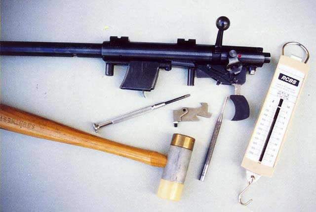

Rifle Basix decided not to build a complete replacement for the factory trigger assembly, but rather to design and build a replacement sear instead.  The new part would take full advantage of the existing Savage mounting frame as well as all of the other existing pins and other trigger parts.  Only the sear, one spring, and a jam nut would be replaced.  All the rest of the Savage hardware would be retained.  This approach insured that cost would be kept to a minimum.  As a result, the Rifle Basix trigger sear costs only $69.95 plus shipping.  This is approximately 35% of the cost of complete custom trigger assembly.

Installing the new sear was not difficult.  First remove the bolt and then remove the gun from the stock.  You’ll see that there are three horizontal pins secured with an “E” clip in the trigger assembly.  One pin holds the trigger arm/trigger finger lever (the rod to which the plastic trigger shoe is attached), another pin holds the safety lever, and a third holds the sear itself.  Remove the clips, and then using a punch or even a finishing nail, tap out the pins and set aside.  Label what pin with what clip goes into what hole as two of the pins and clips are a slightly different diameter than the other.  You don’t want to get them mixed up.
First remove the safety lever clip and pin and detach the safety lever from the side of the trigger assembly.  Next remove the clip and pin for the trigger finger level and remove the lever with the attached trigger shoe.  Lastly, remove the clip and pin for the factory sear and remove it from the inside of the assembly along with the weight of pull spring and the large safety detent spring.  While doing the above, be sure to note the position of the safety detent spring which operates the safety lever.  You might want to even make a rough sketch to insure you get it back into the proper orientation when reassembling.
Now, make sure the Rifle Basix weight of pull spring is placed in its cavity at the front of the replacement sear.  Place the replacement sear inside the gun’s trigger frame in the same orientation as the original sear.  Line up the holes and replace the pin and clip.   Then place the trigger lever back in the assembly and replace the pin and clip.  Lastly, replace the safety lever, safety detent spring, pin, and clip.
Now you’re ready to adjust the new sear.  Re-install the bolt and cock.  Turn the gun bottom side up and at the front of the sear you’ll see an allen head screw.  Turn the screw down compressing the weight of pull spring.  (The appropriate size wrench is provided.) The screw should be turned in from the top approximately .02 - .04” for your initial adjustment.
Now you’ll want to turn in the sear positioning plunger at the rear of the sear just enough to take all movement and creep out of the trigger lever.  When the trigger is set for a light pull, the plunger will be screwed in only a relatively slight amount.  You’ll have to experiment a bit with the settings in order to ensure that you get a creep free trigger breaking at the weight you want.  Once you get the creep out with the plunger adjustment, you can play with the weight of pull spring to get things just where you want them.  You’ll probably have to go back and forth a couple of times with the adjustments to get everything set just so.  Once everything is set, snug up the small nut on the plunger to keep things in place.  Now you’re ready to start shooting.
