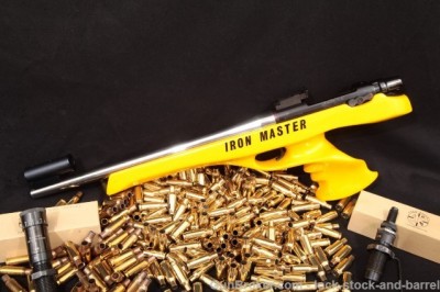

I just bought this gun on GunBroker from a dealer in Simi Valley, CA.
This gun was on consignment so don't know who the owner was.
I would like to get in touch with the owner to get some history on this gun.
It is in 270 BR which I find very interesting having owned other caliber BR guns.
If anyone has any knowledge of this gun please contact me at shultza@watchtv.net
If anyone knows the pervious owner of this gun please pass my email address to him/her.
Thanks for looking.
Lynn
UPDATE - I was informed by the selling dealer this gun was consigned by a widow so I'm hoping that a shooting friend of her past husband will be able to provide some info.

270 br was used a lot in 90's in unlimited standing. Based on where sold, I think Mike Dewey or Jim Harris might know who owned it.

Dan, I have checked with Jim already but he does not remember seeing this gun. I hope Mike sees this thread and has some info.
Thanks for the suggestion.

Lynn,
If it will stabilize 150 grain bullets, I have a couple thousand looking for a new home. My MOA 270 Max either isn't fast enough twist or the 10 inch barrel won't build enough speed and they start to keyhole at 100m.

Seems like I remember that Iron Sight Gun Works built some XP’s way back.

Melvin, I wonder if the name on the stock was a model offered years ago by ISGW.
The gun was advertised as 270 BR but the barrel is not stamped so I'm wondering if it really is a 270 BR.
I might be able to get the gun tomorrow and will check out the fired brass and maybe slug the barrel to make sure.
Sure hope I can get more history on this gun especially if it was built by ISGW.

The guy that owned ISGW before Jim Rock bought it escapes me right now. He chambered a lot of XPs in a case that was longer than a BR and shorter than a 308. I think there is a discussion on down about him. He liked .270. Richard Ottino in Northern Ky had one. If I find it I will edit this post.

Jerry Barlett made the 7 laser, for me & Jim Fields & I still have the ISGW sight book35isit wrote: Wed Oct 23, 2019 10:11 am The guy that owned ISGW before Jim Rock bought it escapes me right now. He chambered a lot of XPs in a case that was longer than a BR and shorter than a 308. I think there is a discussion on down about him. He liked .270. Richard Ottino in Northern Ky had one. If I find it I will edit this post.
Jim experimented using 7 Br brass to make the cases & it worked ok,It just has a short neck.

Bingo. Winner Winner Chicken DinnerJACKIE40X40 wrote: Wed Oct 23, 2019 10:57 amJerry Barlett made the 7 laser, for me & Jim Fields & I still have the ISGW sight book35isit wrote: Wed Oct 23, 2019 10:11 am The guy that owned ISGW before Jim Rock bought it escapes me right now. He chambered a lot of XPs in a case that was longer than a BR and shorter than a 308. I think there is a discussion on down about him. He liked .270. Richard Ottino in Northern Ky had one. If I find it I will edit this post.
Lynn be sure to do a chamber cast or take it out of the stock.

Thanks guys. Keep the info coming!!!
It is at my dealer now and I will pick it up soon. There is a bunch of fired BR brass and also new BR brass so that should give me a clue.
Two Neil Jones dies with the gun are marked 7 BR then have extra info about 270 so will just have to see what I have.
I'm hoping it is a 7 BR necked down to 277. That would be the easiest to work with.
