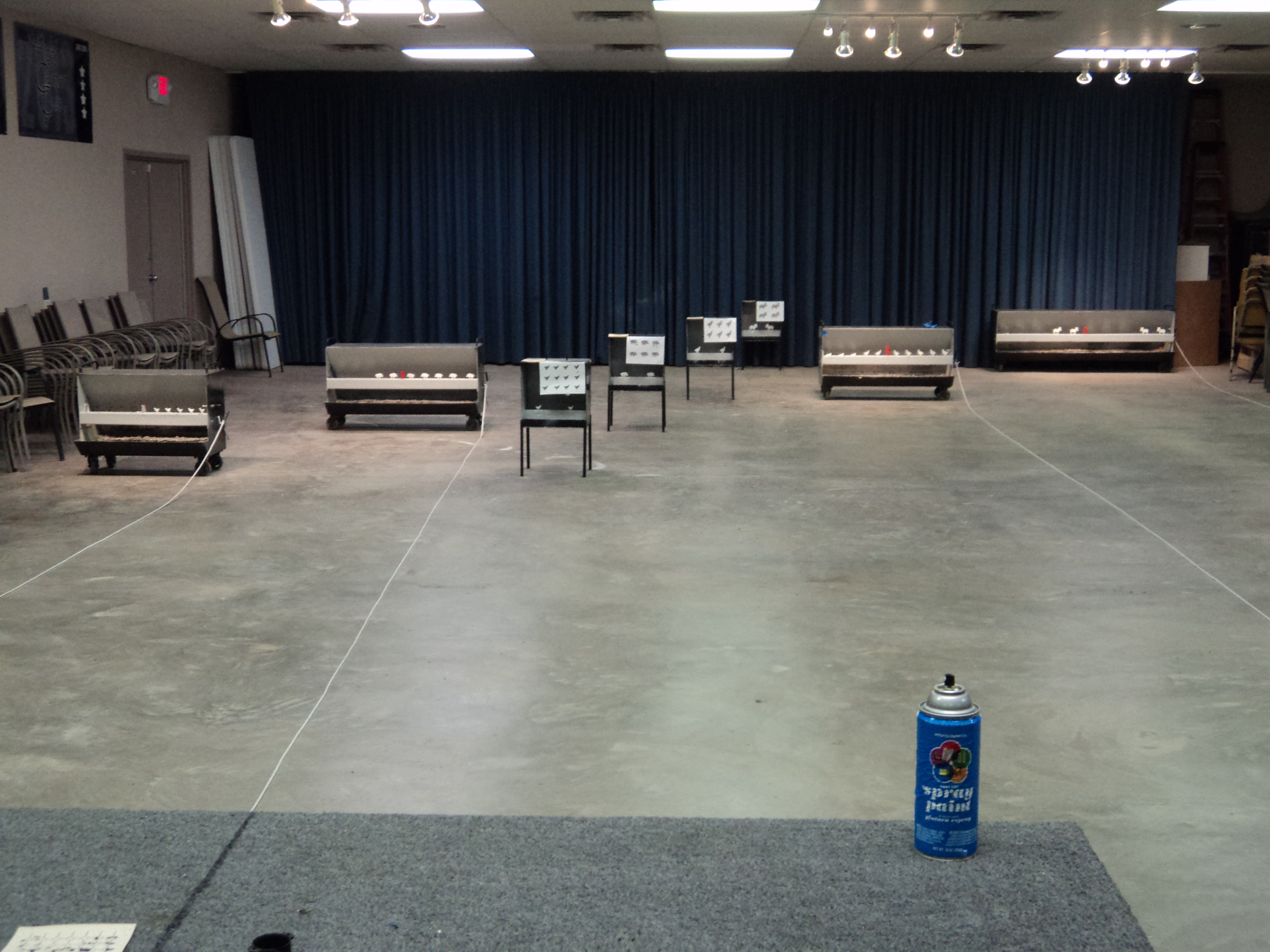

this is the setup at OKCGC.. About the only pic I can find for air gun
