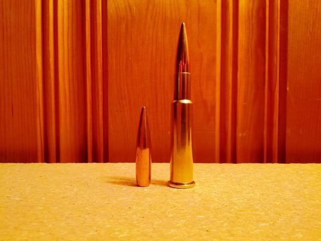

It’s probably a 7 Int-R.
Lots of 7TCU barrels were rechambered to this Elgin Gates cartridge.does it look like this

Yes, it looks exactly like that. Thank you so very much.
