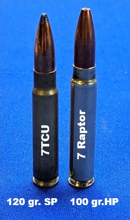

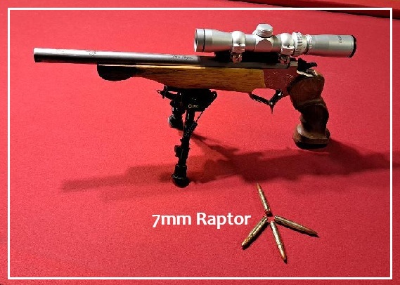

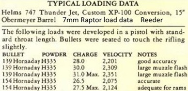

7mm Raptor uses 204 Ruger brass
747 Thunder Jet uses 222 Rem mag brass (7mm bullet)
contact Gary Reeder
contact Gary Reeder
