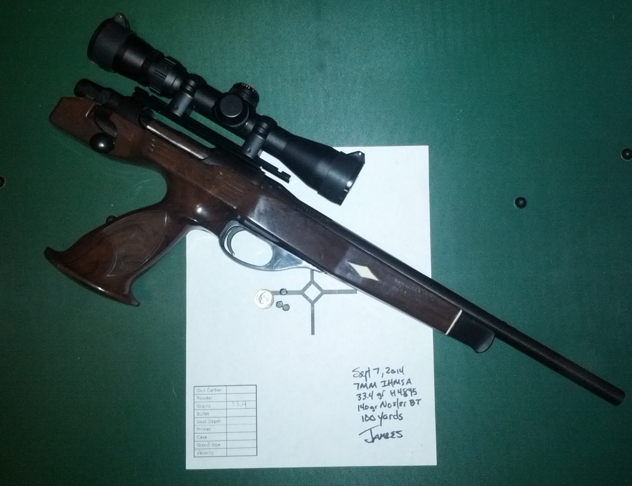

I worked up some loads for the 7mm IHMSA XP-100 I just got at 100 yards. All factory except the mount and scope. Used H4895 from 32.2gr to 33.6gr on 140gr Nosler BTs... Coal of 2.670 and base to ogive of 2.100.
33.4gr seemed to be the best for accuracy and does have some snap. I'm definitely no benchrest pistol shooter, but I'm confident that if this load holds over my next round of tests.... It'll make a splendid deer load, though I think I'll pickup some accubonds and verify with those.
I have to admit... I was stoked when I left the range!!!. The guys to my left and right all shooting rifles weren't getting groups even close to what this lil xp was doing. Everyone wanted to check it out. Not one of my other pistols or rifles ever got a crowd like that... Crazy. Most wanted to hold it and look down range which I obliged. Just wished I had made some extra rounds so that they could have fired one or two as well. Next time!! Don't think I'll ever be as good a shot as the rest of you all.. But very happy with these results. Not sure why the image is so huge, but if I drag it, I can actually see my group. Weird way this posts images.
