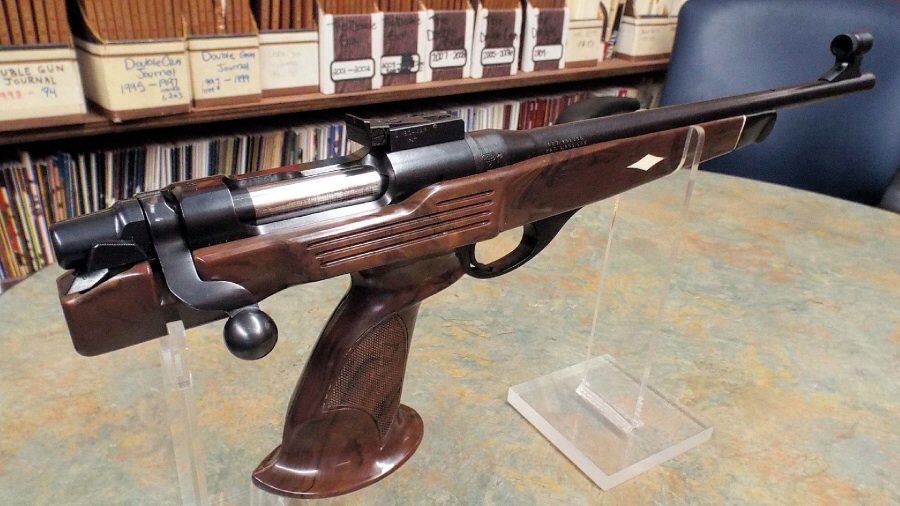

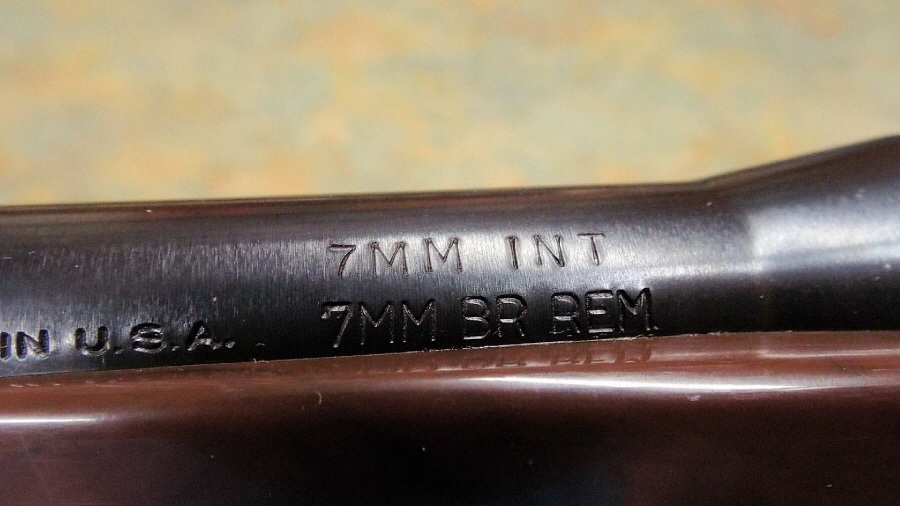

Thanks for the help... So if I'm gathering this correctly, are you saying that the 7int in a 7br rechamber, could be problematic? Is there anything I should look out for when I take possession of the xp100? Man... I'm hoping I didn't pooch it with this purchase. The price was good. I'm hoping there isn't a good reason why! Here's a pic of the barrelAlvin wrote:If it's a 7BR rechambered to 7Int. it will use 7 Int-X dies. A 7Int. reamer will not quite work correctly in a 7BR chamber.....But...we're talking about loads.

When a factory XP 7BR barrel is rechambered to the 7 International cartridge it is actually know as the 7 International-X (aka 7 INT-X) versus a new 7mm barrel that is chambered from scratch for the 7 International cartridge. The original 7BR chamber is not fully cleaned up using a 7 International reamer due to the location of the original 7BR shoulder. The solution was to slightly widen the 7 International cartridge reamers to fully remove the old 7BR shoulder. For all intents and purposes both cartridges are the same but you do need to have 7 INT-X dies to correctly resize cases for your rechambered XP. I have owned two XPs that were rechambered from 7BR to 7 INT-X and they were excellent shooters. Since you are getting the dies with the gun, I'm guessing the previous owner must have loaded rounds for it and has the correct dies. The dies are probably made by Redding and will have 7 International X or some similar designation on the box. If you get 7 International dies they will work but you will be resizing and expanding the cases excessively each time you reload and fire the cartridges. Case life will probably be shorter but you will still be OK to shoot the gun. The Hornady 9th edition handbook on page 730 gives a description of the 7 IHMSA cartridge which is another name for the 7 International. I used 32.0 grains of H4895 with either a Hornady 139 grain or 154 grain bullet for my silhouette shooting. I suspect the 139 grain Hornady bullet would make an excellent hunting bullet. Brass can be formed from either 250 or 300 Savage. Since those two are harder to find, just use 308 Winchester brass and trim to 7 INT specs. For that matter, brass from any of the 308 family of cartridges can be reformed easily to 7 INT-X. It is a great cartridge and is difficult to find a load that is NOT accurate! XPs are great guns and can outshoot many rifles. You will enjoy your new gun and have a great cartridge for your hunting purposes. Don't forget to give silhouette shooting a try with that XP. After all, that is what it was made for.

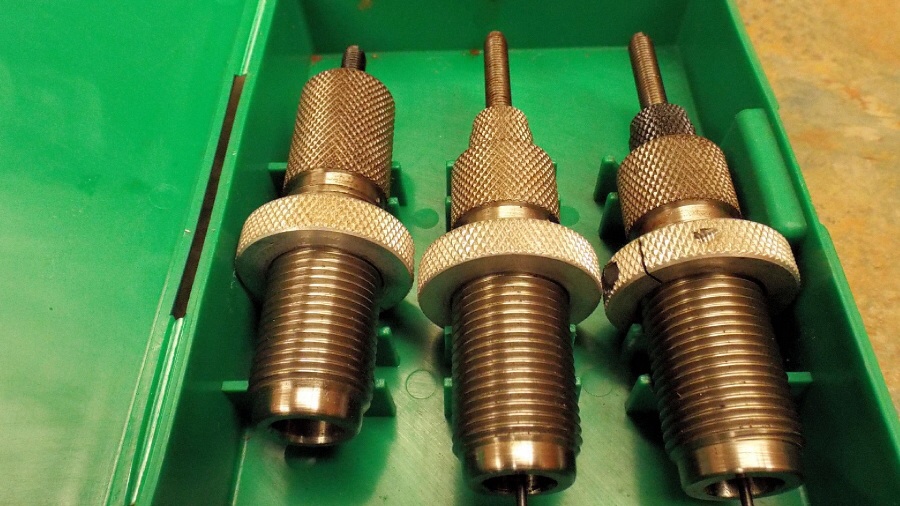

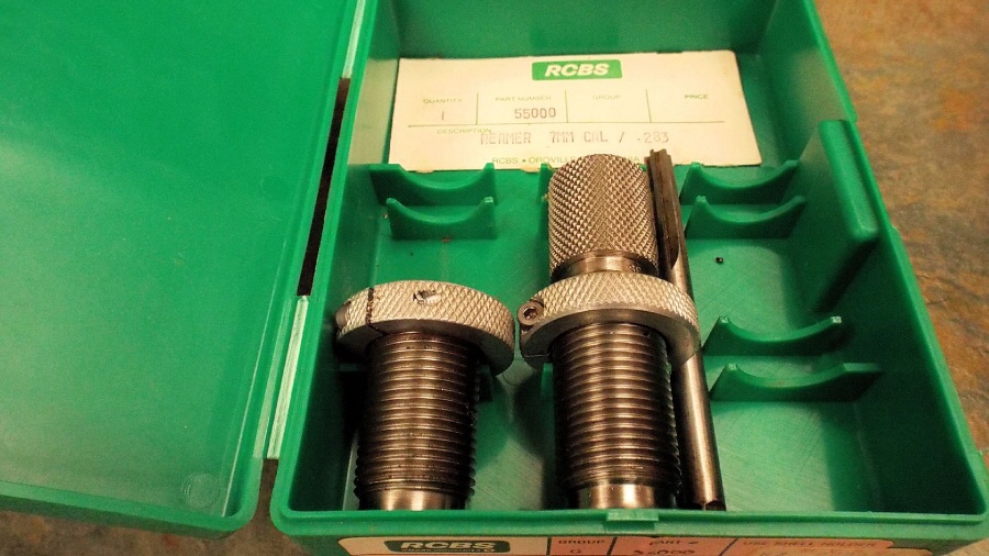

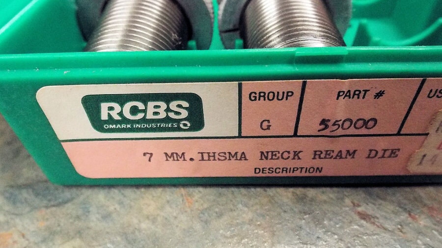

Thank you so much for the help. The dies that are coming with it are RCBS and look like 7mm IHMSA. Here's a couple of images from the sale. So are these right... Or did the guys selling get it wrong? I sure have no clue!

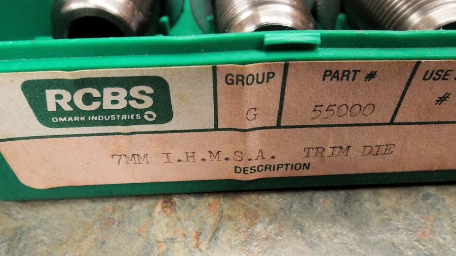

Can't really tell by the pictures if you have a FL die and seating die for the 7 IHMSA. Boxes says ream and file trim dies. If you have a "neck sizing" die for the 7 IHMSA then you can use them to reload your 7 INT-X since they won't work the body of the case and that is where the main difference is between a regular 7 IHMSA (aka 7 INT) and the 7 INT-X. You do need a die that has a decapping stem and at least to size the necks (NOT ream) and then a seating die so you can seat the bullets. Since there are two dies in the "ream" box I can't tell what you are really getting. If you use 250 or 300 Savage brass you will not even need the file/trim die since that brass will reform to the correct length for your 7 INT-X. If you reform 308 Winchester brass then you can use the file/trim die to get the correct length. If you already have a case trimmer, that can be used in place of the file/trim die. You may be OK, just hard to tell from the picture. Just have to check the dies when you get the gun to make sure you have at least a "neck sizing" die and a seating die for the 7 IHMSA. If you need to get extra dies, you can locate Redding 7 INT-X dies (full length sizer and bullet seater) by checking the Internet. They are not plentiful but do appear every so often. Even posting a Want Ad on this forum will probably locate a set for you too. Just have to wait and see what you get in the die boxes. I suspect you will have enough dies if the previous owner shot the gun and reloaded ammo for it.

Thank you! Here's some other images of the dies if that helps. The picture are bigger than the window, but with my ipad, I can move the images around within the post to see the entire image. Not sure what they look like in a pc... But hope you can see these.

I'm guessing the two dies in the one box are a file/trim die and neck ream die. You will hardly ever need these two dies if forming new brass from 250 Savage, 300 Savage (preferred) or even any of the 308 family of cartridges. Trimming will be necessary if you use the 308 family of cartridges but nothing that couldn't be handled by a case trimmer if you already have one of those. The other box with the three dies I'm guessing has a full length die, a neck sizing die and a seater die. These are the ones you will be using most of the time. As tonedaddy commented, use the neck sizing die most of the time until such time you may notice a little harder chambering of loaded rounds. You may then want to use the full length die to resize your cases and then go back to using the neck sizing die again. If you use the full length die, adjust I so you will just come down to the bottom of the neck but not set the shoulder back. Start out with the die away from the shell holder then adjust downward in small increments while trying the resized cases in your XP. You will eventually arrive at a setting where the cases will again chamber with just a slight resistance and this is the setting where you want to full length cases. With five dies, I'm sure you have all you need. If they are the 7 IHMSA and not the 7 INT-X you will still be OK by using the neck sizing die most of the time. I'm guessing the seating die has enough room too even for the slightly larger 7 INT-X cases. You will find many loads that will be accurate in this gun. You mentioned using it for hunting which will work very well but don't forget it was build for shooting silhouettes so by all means give that try too. Silhouette shooting is a great way to improve your hunting skills.
