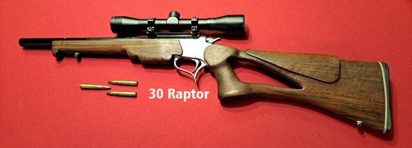

Reeder's Raptors using 204 Ruger case comes in 6mm,25 cal, 6.5mm, 7mm and 30 cal
I shoot the 7 and the 30
the 7mm is a lot like the 747 Thunder Jet
The 30 is like a super 30 Apache
