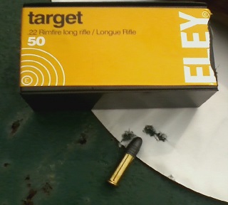

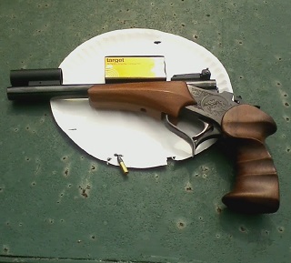

I officially have the silhouette bug thanks to the guys at Tusco. Before I really got into it, I was shooting primarily high velocity copper plated stuff. Now I shoot CCI Standard Velocity and Eley Target. Most of my 22s love the Eley. This past Saturday at Tusco, the Contender with Eley shot everywhere. I was very confident with that gun. My first shoot with it, I shot 18x40 standing. This past shoot just 11x40. I know I am a big variable in all of this, but I know I made some good shots. My brother was spotting and telling me how far off the shots were and I couldn't believe it. I have about a brick through it without cleaning. I did see a lot of unburned powder in the barrel. Today I cleaned the barrel and went the range with the Contender wearing it's new High Plains Gun Stocks Hammer grip. I shot it 6 o'clock hold as usual at a poor man's target off the bag at 25 yards. There are 5 shots that measure just under 5/8". Those were the first five shots after cleaning. I was more than happy. My question is, how often are you all cleaning your 22s especially if you shoot Eley? Does cleaning affect your zero?
