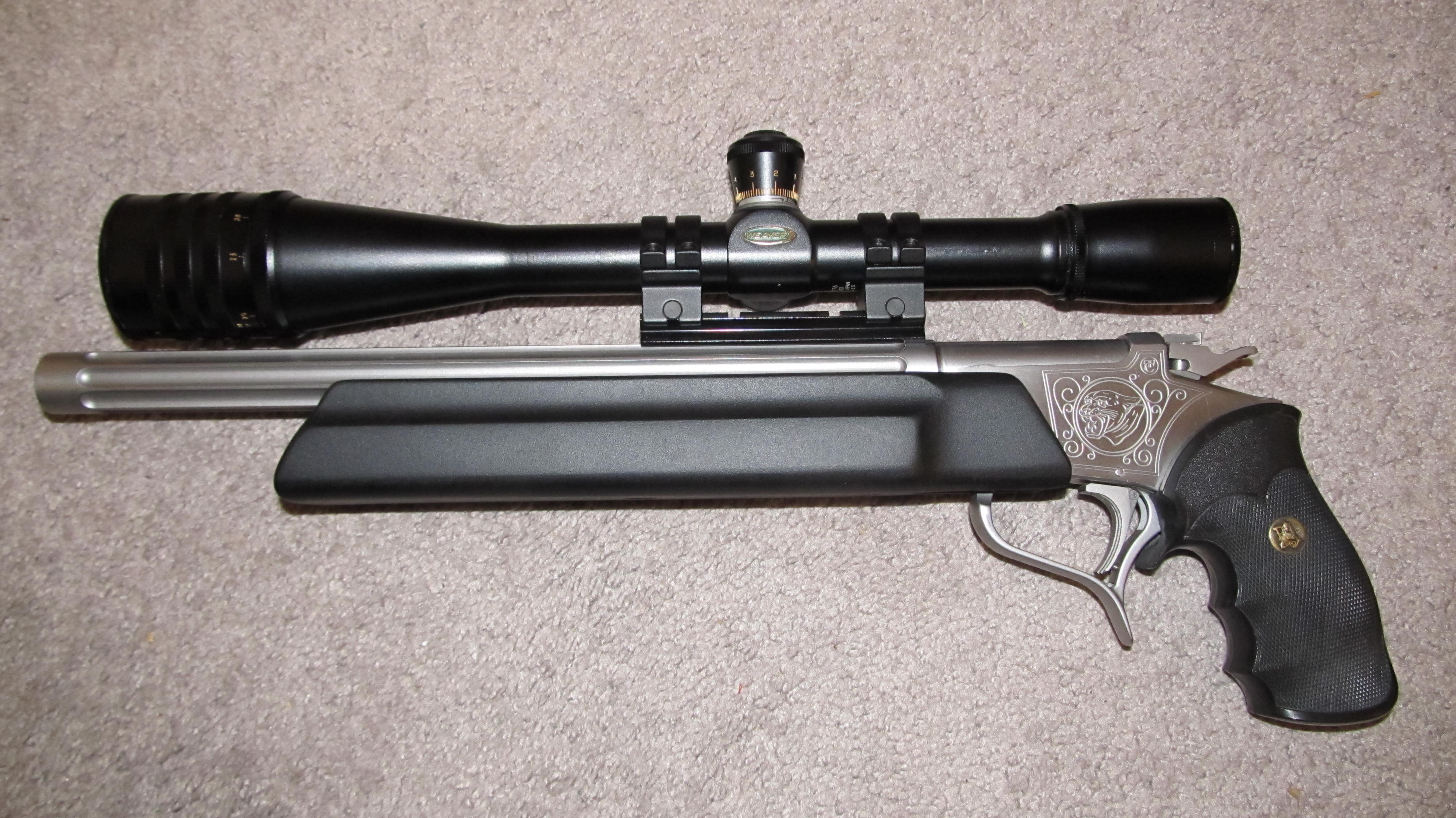

- Posts: 667
Re: Contender caliber for flop
