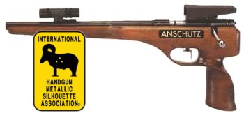

You mention Merits. Can you use a rear peep in creedmore? I use a Merit on my lever gun and it seems way too small at arms length.
Also, What is this rear sight? Some kind of hood for the rear sight?

the merit peep sight attachment is mainly used in the prone (Flop) position. it does not help much in creedmore as you are too far away from it. a lot of us use the Merit optical attachment on our glasses as it helps bring the target into focus.
looking at the sight, it most likely is a Bomar rear sight with a hood. the front sight is an OLD anshutz front sight.
