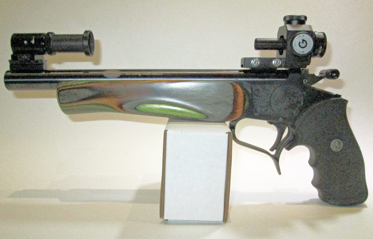

Here is what I'm using for peeps on my small bore production TC. Gehmann on the back, Anschutz on the front. Everything is OTC, production legal.jmoore wrote:Pretty well. The biggest problem has been shooting the correct target. (On more than one occasion I've either shot the sighter or. less often, the animal to the right of the one intended.) Have since gotten rid of the front peep cross bar for a floating variable size aperture and swapped the too fine Anschutz sight out for a Palma. If we try fifth scale again, an Anschutz rear sight will probably have to go back on, but likely it will be a newer unit than the ancient thing we were using which doesn't have a functioning coarse setting, so it was too easy to be a turn off. In actual fact I'm not shooting it much, currently, except for testing purposes, but it IS being used in matches regularly....I think Lisa will have her first 40 soon.contender1121 wrote:

I like that setup. Are you using a peep or post on the front?contender1121 wrote:Here is what I'm using for peeps on my small bore production TC. Gehmann on the back, Anschutz on the front. Everything is OTC, production legal.jmoore wrote:Pretty well. The biggest problem has been shooting the correct target. (On more than one occasion I've either shot the sighter or. less often, the animal to the right of the one intended.) Have since gotten rid of the front peep cross bar for a floating variable size aperture and swapped the too fine Anschutz sight out for a Palma. If we try fifth scale again, an Anschutz rear sight will probably have to go back on, but likely it will be a newer unit than the ancient thing we were using which doesn't have a functioning coarse setting, so it was too easy to be a turn off. In actual fact I'm not shooting it much, currently, except for testing purposes, but it IS being used in matches regularly....I think Lisa will have her first 40 soon.contender1121 wrote:

Re: Anschutz Exemplar mounting threads
Thanks Melvin.
Actually it is neither. I make my own discs and apply a very tiny dot in the center. Works well for me.
SSSSSSH, don't tell anyone you are making your own front insert or it won't be Production legal anymore. According to our current rules you will have modified your sights. Now me, I don't think your homemade disk is a big deal but at the Internationals that would not be allowed. And I am NOT even trying to be a rule Nazi.
