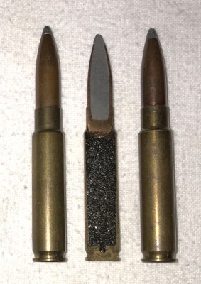

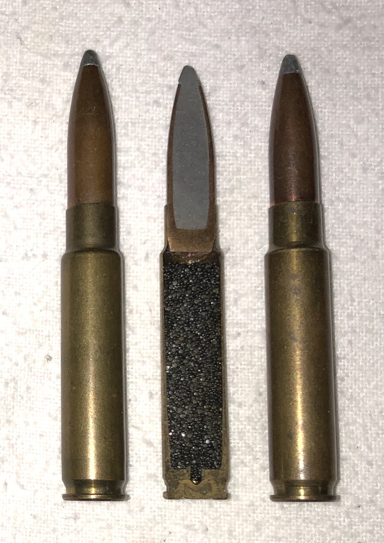

Joining in a little late, but back in the late 1980’s to early 1990’s I shot IHMSA Unlimited with a Contender in 7T/CU and a XP in 7BR. At first I was using Speer 130 gr and 145 gr BTSP. With a high center shot the rams sometimes just rocked. Then a new friend’s dad had a FFL and we ordered Nosler 140 gr HB’s. (Pre BT’s) Then my high center hits nocked the rams down 100%. The reason is the Nosler has an internal tapered bullet jacket with a thick base. This bullet I believe has more dwell time on the ram thus transferring more energy. Nosler’s are indeed more expensive, but if you want to win matches such as I wanted, paying twice as much for a premium bullet paid off in my case.
