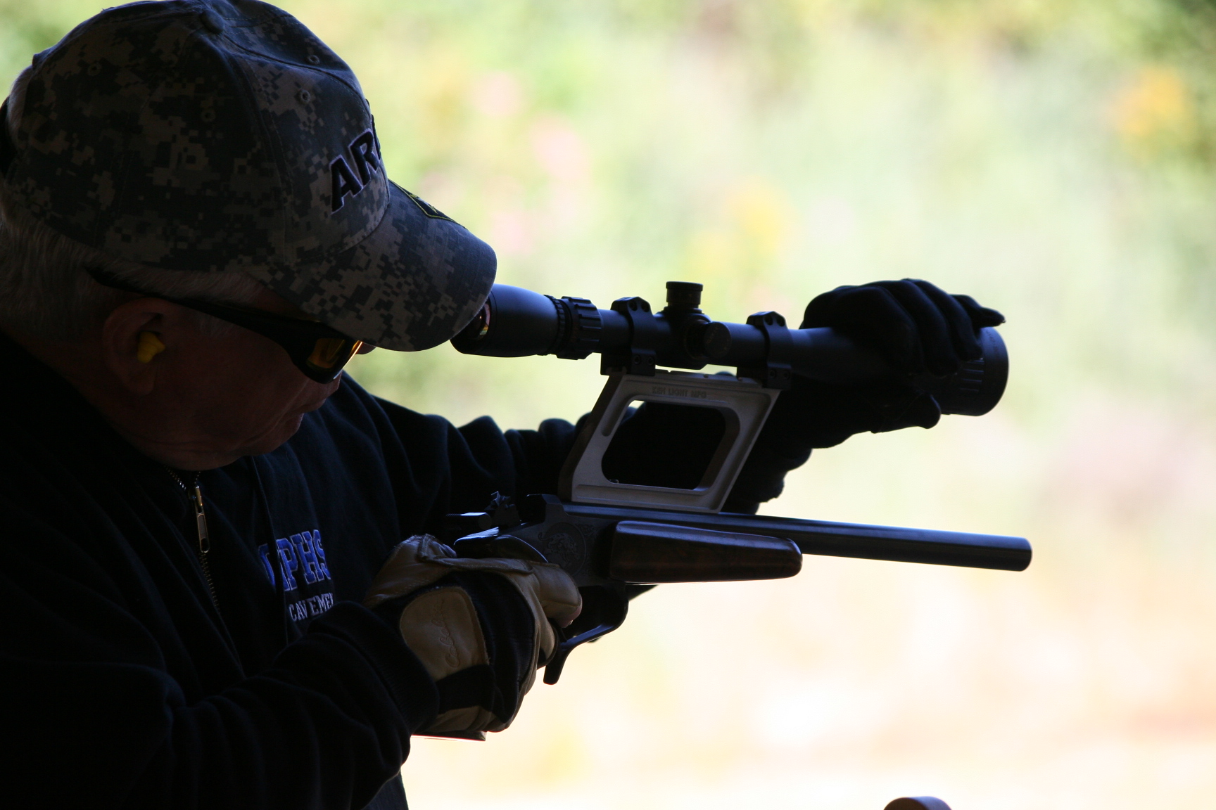

Using a rifle scope so right hand on the grip and left hand around the front bell of the scope. Both elbows bent, scope pulled close to the right eye and arms off the body.
If you are a lefty switch everything.

This standing shooting position is very similar to that of a typical rifle shooter. Right hand holds the grip and trigger. Support hand does the aiming by holding the front scope bell at eye level, rear of scope is about 3 inches from eye. Remarkably easy to transition from offhand rifle shooting. Makes indoor practice easy in all seasons with a good scoped pellet gun like the 46M.
Just like using peep sights in standing, the whole purpose is to bring the gun balance and center of gravity closer to your chest. Emphasis on arms CANNOT touch your body or the other arm, face or hat CANNOT touch the gun or scope.

This Pic shows the hold most people use. where to hold the gun with the left hand (reversed for lefties) will vary by shooter. Most will hold the Bell of the scope, others will hold around the adjustments and some put their hand through the hole in the mount.

On a related note, my Taco Hold guns have the scope canted a few degrees off vertical. I'm right handed, and canting the scope in the rings a few degrees clockwise forces my right hand/arm slightly away from my chest, assuring me of a legal position, clearly visible to others, when sighting thru squared and level crosshairs.
