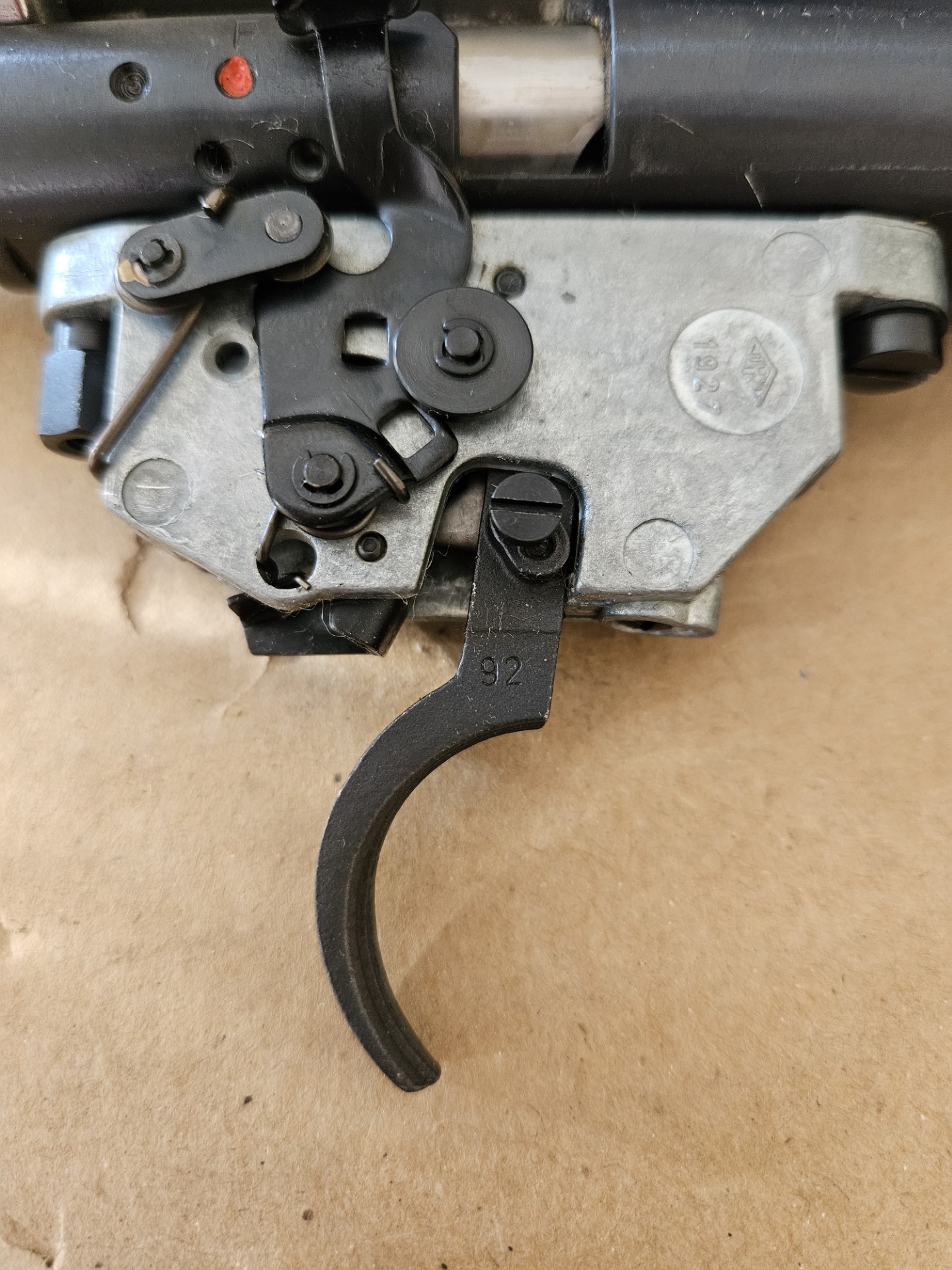

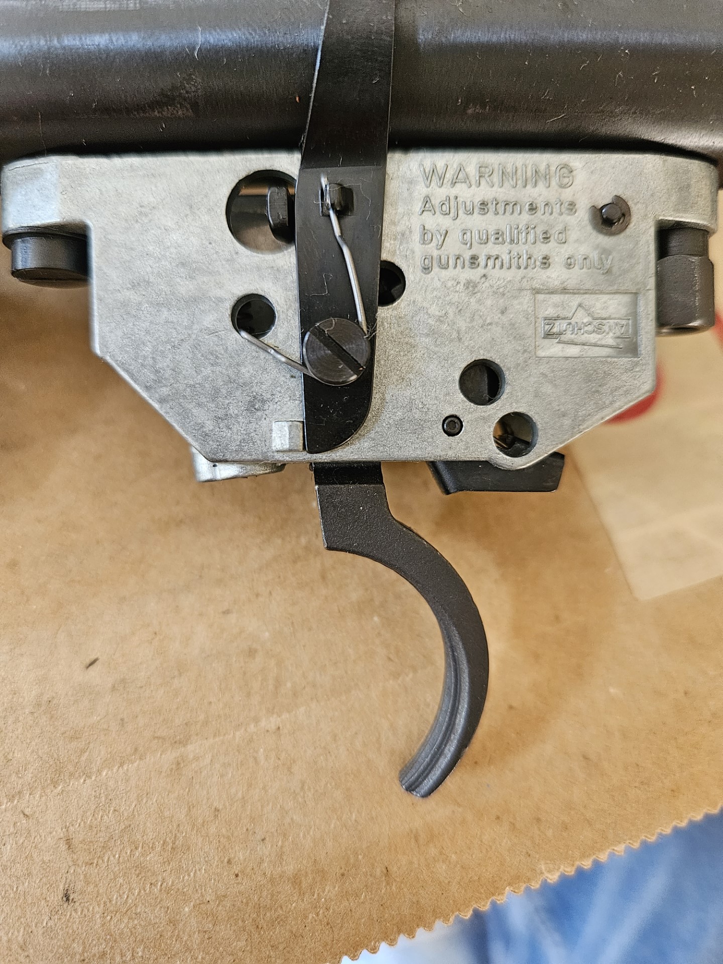

Post by SteveJewels »
Trigger on a 64P. I don't find a number I associate with an Anschutz model number. I would expect it to be a 5092.
Thanks!

Re: What trigger is this?
yes, it is a 5092 2 stage trigger. that is what came standard in the 64P
Posts: 508
The trigger was one of the biggest differences between the 64P and the exemplar. The 5092 is listed as 800grams.
I had gotten the one in the pictures down to 21 oz. And Anschutz techs told me that was borderline not safe. They said it should be around a pound and half. 24-25oz.
There is one replacement competition trigger from Anschutz that is much lower and that is the #5098. It is listed as a 180 gram trigger. In actual practice it is supposed to be 5 oz. To 12 oz.
I do not know if Mike Dewey’s or Dell Taylors Exemplar trigger can be adapted to this. They were both designed as Mid grip conversions so I dont know.
Dan Hagerty might have a better idea if Deweys or Taylors trigger would work?
BTW the cost of the 5098 is $425 from Anschutz but can be found cheaper from other suppliers
Post by aggshooter »
Didn't the original Exemplars come from factory with triggers at 10.5 ounces?
Posts: 508
The exemplar had a different trigger and i cannot tell you the number of the trigger but it was a two stage and between 8-10 oz.
