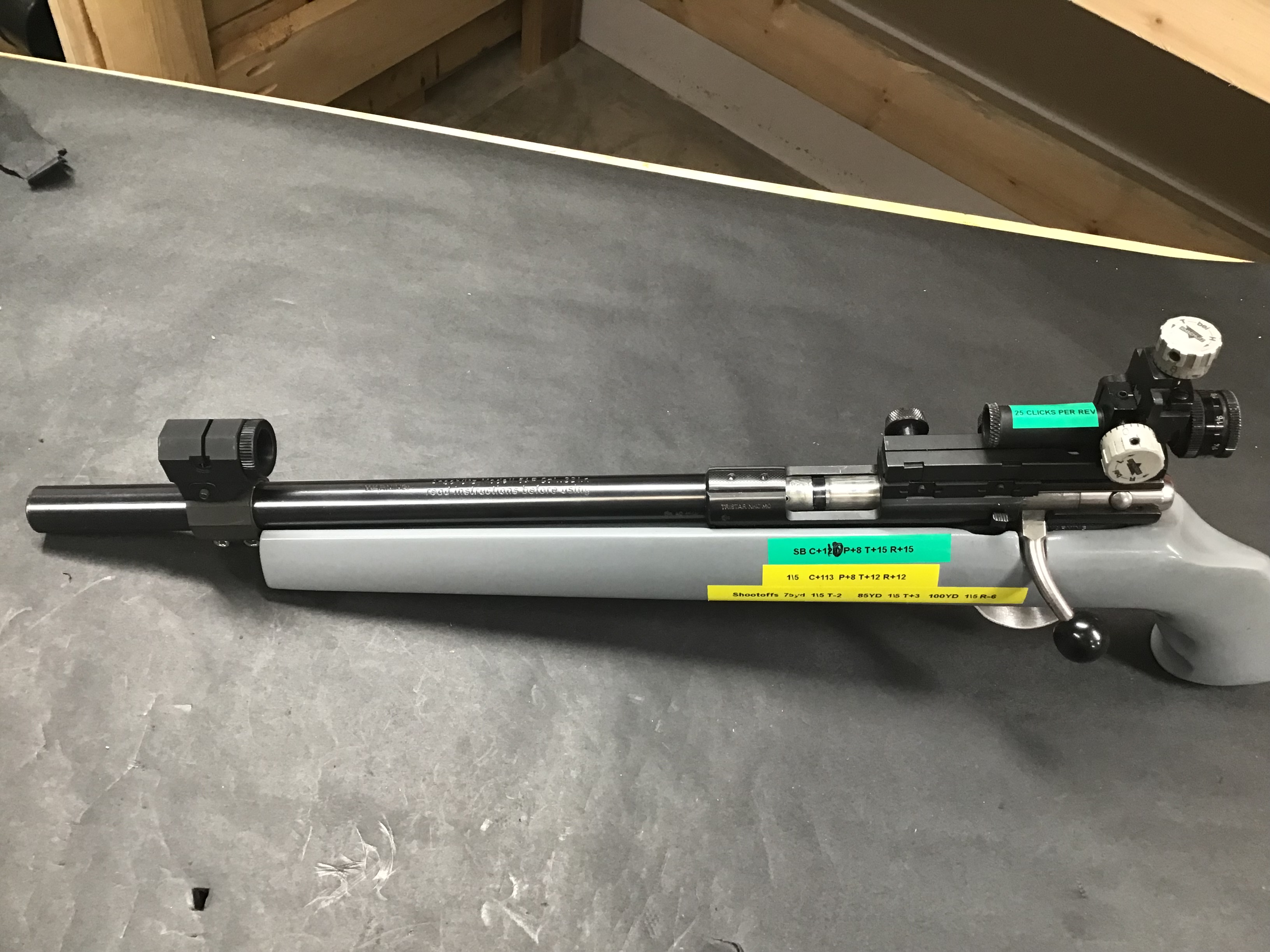

Re: Exemplar vs 64P
Here is a left hand 64P. Ive seen a couple but not common. Maybe they were some of the early ones. This one was in a standard black 64P rynite stock. The stock that its in is a 64 rifle stock that somebody cut down for benchrest pistol I think.
